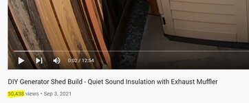

I also had an idea for a generator muffler that might work. It is based on the design of a standard glass-packed motorcycle muffler, only on a much bigger scale. It turned out great! I call it the FrankenMuffler. You can see it in the video below, and I'll post some more details later on the parts I used. Not really a portable option, but it works better than any solution I've seen so far.
I also noted that one of the other big sources for noise were the air inlet/outlet vents in the shed. I used some scrap wood and leftover sound insulation to build some sound baffles that fit over the vents. They also worked really well. When not in use, they can fit in the shed with generator.
For sound insulation, I went with Rockwool, which is mineral wool rather than fiberglass. I used the semi-rigid ComfortBoard 80 for the interior of the shed and the inside of the baffles. I also used a combination of the rigid boards and the fluffier batts for the material inside the muffler. It is not only a great sound insulator, but it is fire resistant to over 2000 degrees F. You can hold a torch to it and it won't burn or melt. Really cool stuff, so to speak. My main strategy was to absorb the sound energy where I could, and to change the direction of the airflow when possible. Air goes around corners just fine, but sound doesn't really like to turn unless it is reflected.
Anyway, more info to come on the generator and how to make the muffler, etc. But take a look at the vid below to see how the shed turned out. There are some links in the comments to some earlier sound testing I conducted with just the bare plastic shed, and also with some sound insulation but without the muffler.
