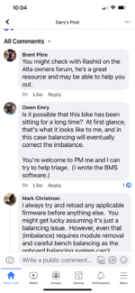

Yes, that was my concern. If we replaced the cells or modules, would it communicate or would we need to change something software or BMS related. One of the guys on an Alta page and possibly one of our members wrote the software for the BMS system. Maybe he could help us with that? Probably a good chance you already know him.
