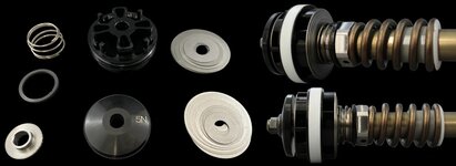

After my 1st revalve I found the Alta AER's restrictive OEM damping piston still had too much compression damping and was really hard on shims, so I replaced it with a Krooztune hi-flow MV-float setup (I think the Krooztune may have the most flow possible in an aluminum piston). My goal here was the same as my Ohlins shock - max grip, min. pain. I need my suspension to be workers, not fighters.

Mid-valve 'float stack' (8mm ID, basically a check valve - see float-setup pic below, works EX)
30 x .10 [x3] float shims
20 x .10 spring buffer

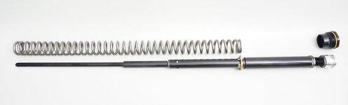

After that, I put in a Race Tech FSCS WC38050915 'stealth' spring-conversion unit ($534 shipped with the 10% ThumperTalk discount) to limit extension and provide a 2nd top-out spring (the OEM one in the RH damping leg wasn't enough). I figured if the air thing didn't work I'd go with steel; no way the air spring's going back in. Below is a pic w/spring (not used):
The RT unit is high quality and light - @ 1 lb/480g, about the same as the air spring. 'Stealth' means re-using the stock cap, so remove it fm the cartridge (tools needed are 37mm tube clamp / vise / torch / cap wrench / etc.). The cap bleeder / Schrader valve ass'y / O-ring must be removed and the torch used on the cap's black outer threads - the inner super-fine threads w/red Loctite to be loosened are under them. I had to apply heat twice to finally get it off, but no damage. The Schrader valve and bleeder screw should be reinstalled in the cap in their OEM positions, then the RT unit can be set up & installed in the LH fork leg per the instructions (remove & save the spring seat / ring nut / washers / large-OD spring sleeve), along with 680cc of any type / weight fork oil. Once it's together & back on the bike (0 psi), put the front wheel on, add 36 psi of air, done.

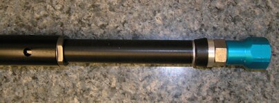

The LH spring & bumper had to be reduced in OD to fit the Race Tech unit's ID, the RH worked fine as-is. Not a trace of topping out now, even with increased air pressure.
The LH leg also had its travel-limiting spacer shortened and got a new rubber bottoming bumper that contacts 2mm prior to RH-leg metal-metal impact - it hopefully will never be used, but I'm glad it's there. It's a huge improvement over the stock Race Tech setup, with it's spacer hard-bottoming (clack!).
It's amazing to me how much faster I'm riding on this setup - yesterday I lost control again and went off into the weeds, luckily no giant rocks to ruin my day. :) I'm also surprised how soft the suspension can be run as long as there's no danger of bottoming (I occasionally engage the RH leg's hydraulic bottoming cone, but I never feel it).
