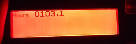

Anyone else had an issue where they're display only shows hours in the top left?
Things I have tried:
Updated to latest firmware
Downgraded to old firmware
Clicked all buttons and all combinations of buttons (I think)
Just getting kind of annoying not being able to see my battery level while riding...
Amy thoughts/help would be AMAZING!

Sounds like it thinks you are holding down the right button. Either stuck button or wiring??? Have you tried smacking it to make it behave? Sometimes machines will respond to fear rather than kindness. Casually mention e-waste disposal companies when you walk in the garage to see if it responds.

I have tried to smack it about a bit. No luck, also tried to push the right button a bunch thinking it was stuck. Still has tactile feel so don't think it's physically stuck, but might be an electronic issue is was i was thinking sadly.

The switch underneath might have shorted.
