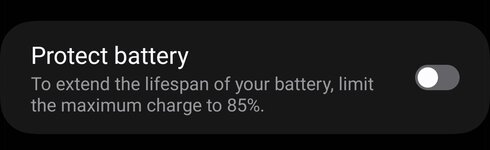

but thats for the phone itself i think right? shouldnt interfere with the bike, let me try, thanks!
268
I
I just see It, i have It unable, and im pretty sure thats for the phone not for the bike
