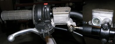

At this point things were better but still not quite there, so I put on the Nissin '3/8' (.375" / 9.5mm-piston) master cylinder from my wheelie-practice bike (used on Yamaha '08 YZ250F and many other YZ's, eBay etc.), for a 12.7:1 ratio. I like the Nissin lever a little better, and I can adjust it closer to the grip. I also like the front hose connection, which adds a little hose slack & routes it away from the number plate.
It was definitely an improvement on the Alta, but not like it was on the other 11mm-MC system. My front brake is now instant and consistent, though not as powerful as I'd like. I may go to a 9mm Nissin or Brembo MC in the future (p/n 10767774, OPP Racing), but I've got consistent 2-finger braking now so I'll live with it for a while.

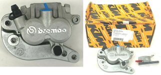

Front Caliper Replacement (2 x 28mm pistons)
Instead of the big rotor, I went with big caliper pistons - wow, what a difference! I used a Brembo 22.7610.00 2x28mm caliper (KTM p/n 59013015101, used on the '09 250XC-F and many others). Apparently Andrew Short used this with a 10mm master cylinder during the 2015 SX season, when he was the king of holeshots. It bolted right up, but it's bigger and 270g heavier - no free lunch, I guess. (a 320 rotor would've been heavier too, though). I got my caliper NIB on eBay for $186 shipped ($290 list).
Installation did not go well - the bigger cylinders hold a ton of air, my Motion Pro 8mm mini bleeder was the wrong size (this one needs a 10mm), and the copper crush gaskets leaked with 11 ft/lbs on the banjo fitting. I went with Honda 90545-300-000 aluminum ones + carefully-applied hard-setting Permatex, no leakage.
Even after successful bleeding the lever felt soft, so I figured the first test ride would last about 50 feet. Wrong! Regardless of the feel in the garage, on the street it was instant and potent, with a more linear response than the on/off 24mm caliper. This setup feels exactly the same with 1 finger as it did before with 2, which was just what I wanted - as long as I remembered just-one-finger, I was instantly comfortable with it despite the big power increase.
After a dozen or so hard brake checks, I noticed two things: 1) the rotor was too hot to touch, it wouldn't have been before (caliper was cool, though); and 2) the rotor surface & old pads were finally making 100% contact, despite extensive break-in. High pressure did in minutes what medium pressure couldn't in months. I like high pressure. :D
DESIGN NOTE: to any company spec-ing out a brake system (Stark?), check out the list below and consider using big-piston calipers, which give a much wider range of power adjustment using easily-available & installable master cylinders.
