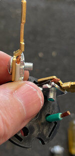

Check your charger wires mine were not stripped far enough to create a good contact.
Confirmed!! I assumed this was Fake news for sure, but I opened mine just to check found 1 not good and 1 half as good. In the end I had to strip and reconnect all 3 wires as they were too short to make good contact, Make sure to put the wires back on the same side of the screw as you took them off, or the backing plate will not line up with the Tab. Thanks to Fog 25 for the post !
