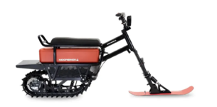

Given your mission parameters & operating conditions , a tracked electric would seem about the only viable option. On a conventional round wheel bike, those narrow-ish rolling wheels wont perform well even if fitted with studs when pulling a payload, it'll want to dig down more than forward. Hence the wider track arrangement - lots more forward motion than wheels.
Tracked electrics are quite new & thus lack any kind of operating history ; Reliability is an unknown, but it does appear to be a simple machine which could be of value for it's intended use.
Moonbike - electric tracked vehicle
