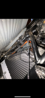

Do you know where to attach the OBD? I found the red square 6 pin OBD to black connector plug. But it looks like there’s only two female black plugs underneath the charging station. One for the throttle and the other for the control switch. My code reader isn’t turning on when I use either of those slots.
Do you know where to attach the obd
You'll find the plug on the right side under the plastics just above the battery on the frame. Remove the two front bolts on the right shroud and you should be able to bend it away just enough to connect the adapter cable without having to remove the whole plastic/seat assembly.
Ok I think I found the right plug. It looks like it might go to the rear brake foot lever?
I connected it to my OBDII code reader via an adapter and got nothing. Tried it both while charging and just on. Code reader doesn’t turn on
My reader needs 8-18V DC it would seem. So maybe this wire wasn’t providing that much voltage? Don’t have my volt meter to test the wire’s voltage.
My code reader only turns on when plugged into a running vehicle
Interesting, do you know what firmware you currently have? I wanted to make some pictures for you and plugged in the same setup which has worked fine last time and got - NOTHING! Basically all the OBD dongles have some LEDs to show the current status and after turning on the bike it showed no power to the dongle this time - only thing different to last time is the updated firmware on several modules including the VCU (1.2.8). So I can only assume that Stark disabled the OBD port or did something to the power supply on that line - is it really used for the rear bake switch as well?
