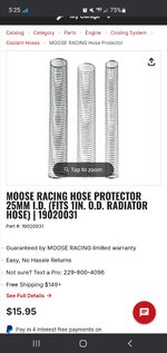

That's awesome, but sounds like a lot of work ! No not a better loom just a extra in case. I used these to put around the head set wire loom. It'll have to be taped so I don't scratch the paint. I'll take pics once installed.
