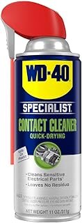

Good Call I had RED Light of Death before I started, and a creeping red light when I shut down Saturday last. The CAN BUS connection did not fix my issue, the VCU connector was my issue, but good time to clean them all on yearly maintenance. Oh and the twist lock connection under the Frame, I checked that too and used compressed air blew a small black gasket out of that and lost it, don't make my mistake! If anyone is in there I need a pic of the Code on the connector should be like 4 letters, "KTXD"?
I used WD40 contact cleaner maybe some compressed air, then I go back with DeoxIT brush on the Pins, let Dry. I only apply Dielectric grease to the connector Seals with a Q-Tip not getting any on the Pins or Contacts I just cleaned. Bike responds and feels like new.
