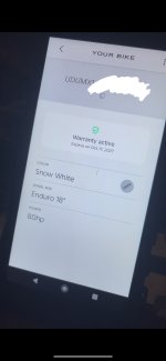

Now when switched on the bikes flashing yellow and won’t update when try.bike works as normal but haven’t got crawl modes option.the firmware version isnt shown in the settings>your bike section in phone app like in pic,phones on current correct 1.0.187(441) so am waiting to hear back from stark ticket hopefully Monday morning.think they'll need to force the update remotely
