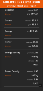

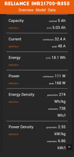

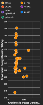

For all the battery geeks out there, take a look at Batemo website.
Here is an overview of 5 Ah 21700 commercial cells.
Molicel P50B is 2nd from the bottom in energy density... but it's 4th best when it comes to power density (most are about half of it, Samsung 50S are closer).
Power champions are Reliance RS50 and Highstar 50PS (with equal or better energy density than Molicel P50B).
Of course, energy density and power density are great for spec sheets but cell degradation and thermal limitations under intended use are paramount. No doubt Stark took some time to test that.
Please note that peak power is referenced for Batemo as power sustainable for 5 min (which is an unlikely scenario for motorcycles).
Hence they give Molicel P50B peak power at 136 W while Molicel states max power at 397 W (10 s, SOC 100%, 25 °C) and 228 W (10 s, SOC 50%, 25 °C). Max continuous discharge current of 60 A gives power of 216 W at nominal voltage (3.6 V).
Anyway, to make 80 hp (60 kW) with a 400 cells pack, one cell needs to supply 150 W peak power, which eliminates A LOT of potential cells.
Molicel P50B can supply that for a few seconds, Reliance RS50 and Highstar 50PS can provide that for at least 5 min.
Furthermore, using cells like Reliance RS50, peak power from 400 cells pack would easily go over 90 hp (provided the motor, BMS and the rest can handle that). Max power would likely be higher, in the 100 hp range, given it's reaching 90 hp with power sustainable for 5 min.
