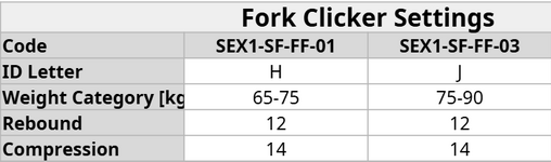

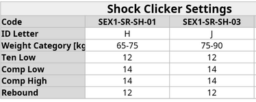

E Erwin P Spam Assassin Staff member Likes 553 Location Netherlands Mar 20, 2026 #1 Could anyone help me with a chart of the stock settings per weight on the Stark EX? I have one for my MX 1.0, but Tomorrow i will be racing a Demo EX. Edit: Answer from Stark:

E Erwin P Spam Assassin Staff member Likes 553 Location Netherlands Mar 21, 2026 #3 Sadly Sam wasn't able to help. Nor the manual. The bike had medium springs, but in the end the clickers weren't the issue. For a previous testride they set the SAG so low the handling was quite abismall
E Erwin P Spam Assassin Staff member Likes 553 Location Netherlands Mar 24, 2026 #4 See OP for Starks answer.
