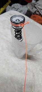

So I can report back that taking fork oil out doesn't make any noticeable difference at all. Tried 10ml and 20ml removal. I put zip ties around the forks and shock to see how much travel I was using. I was really surprised to see the shock was completely bottoming out to the bumper. The zip tie was pushed down into the rubber bushing. The forks however have about 3-4" left of travel.
It's really hard to know what the right thing to do is. We rode the bike around a small track with small jumps and that most likely is what got the travel to go lower. But the average riding we do is slow technical stuff so I'd like for it to be more compliant over more range yet still have high speed compression available. This really is why taking it to a pro is the right thing to do. But I'm stubborn and really curious to play around with the shims a little before throwing in the towel. The plan is to leave the shock as is and remove 2-3 face shims on the forks comp stack. Will report back.

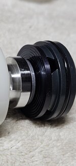

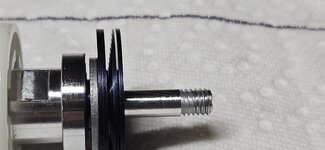

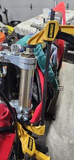

I went at it last night. I was able to remove the base valves relatively easily while in the bike. I had to take off the bars though. I wouldn't recommend doing this if you're not a patient, mechanically skilled and methodical person. There are a lot of areas to mess things up at. I don't really feel the need to go into each step but I'll show what it looks like. I was really surprised to see there are 20 face shims!1000005159.jpg

I went at it last night. I was able to remove the base valves relatively easily while in the bike. I had to take off the bars though. I wouldn't recommend doing this if you're not a patient, mechanically skilled and methodical person. There are a lot of areas to mess things up at. I don't really feel the need to go into each step but I'll show what it looks like. I was really surprised to see there are 20 face shims!View attachment 12208
Good job mate. I wouldn't come close myself. Let me know what you plan on doing. Also some useful information on YouTube about shims etc, I presume you are watching before changing stuff.
So you removed the compression valving without disassembling the fork any further; I've never seen anything like this before, but if it worked I think it's ok. It seems that you also needed that yellow DeWalt trigger clamp when putting it back: I guess you couldn't bleed the inner chamber and so it was too hard to do it just by hand...

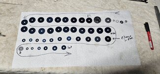

I have a few friends that are self-proclaimed KYB gurus and I took a leap of faith having their expertise at my disposal. I figured if I couldn't get the base valve back in I could always take it all apart and do things the "correct" way. The base valve core unscrews easily with the top triple clamp bolts loosened. With some gentle finessing you can tie a thin line under the threads and gently pull upward. And yes, the clamps were a simple way to gently control the force needed to get that damn thing back in there without cross threading the cap. I was told a little air will bleed out but you wanna be as close to the original level of oil if possible. The goal is to keep as much of the oil as possible so I went straight to the container and let it drip for a long time. Then wrapped it up nice and tight with rubber gloves and electrical tape to file the nut. I was not 100% sure if the peening on the center of the shaft was needed for holding the clicker tube so I was very careful to just take off the perimeter. This is much smaller than I had imagined from all the online material I've seen. This is surgical work! I placed a toothpick in the center to keep filings out. I used a toothbrush to wipe away any shavings every few file swipes. Takes time. But after very carefully laying out the shims and labelling them I had a conference call with my 2 KYB gurus and we decided to go with 8 face shims out of the 20, use the smallest washer on the other end as a x-over, then 2 face shims followed by the stock taper. I used the rest of the face shims to build the height back up which may not be necessary. I think there were enough threads left over to squeeze the shims down but we will see. There is so much to know about this dark art. At a certain point when the base shim stack gets too "light" it will place unwanted load on the midvalving. I got my suspension to use almost all of the shock travel and the forks down to about 3-4" left of travel. I ride slow technical stuff and wanted all the travel. We figured if we air on the softer side then we can get the compression clickers more in the middle of their click range. I have no idea what comes next. This is the deepest possible rabbit hole one can get into on a motorcycle. It's absurd and consumes ones life. It makes spending $1200 to have a pro do their thing all the more worth it. But I enjoy nerding out on how things work. I will report back as to how my new shim stack does. Unfortunately I can't test this out on my street and really need some rocks to bash into. I'll get back ASAP.
Also, if anyone in the know can say if this is a good or bad idea to take the remainder of face shims and placing them on the other side to make up the overall height of the stack, please let me know. I don't fully understand the flow of oil around that back part. You can see in my pic the stack of larger shims on the left side were part of the right stack originally.
It's like anything in life, try and see... I suppose the advantage you have is that once your try and test it and if your not 100 percent happy you can then adjust it to suit. The only downside is the time and effort it takes you to get to that point. I have to much on my hand to even give it a go 😁. Good luck with it man looks like you are on to a good start.

I have read in other forums that some people use Shim ReStackör to speed up the process: you can consider it.
Upinsmoke57
Re stacker is good to get a ballpark of what's going to do what. Nothing will really determine the way it feels like just going at it and trying. The other thing is I was not prepared with a surplus of shims to adjust as needed. Initially I was only planning to remove 50% of the face shims. I was talked into making a crossover(2 stage) using a small shim. But there are some points of concern with what I did. I'll test it shortly. If all goes well and do actually notice a worthwhile result I'm happy to share what I ended up doing. Of course all of our weights, riding styles and environments are different. But I think we can get close to what we want for those of us using the bike for slower hard enduro. Fortunately it seems to be less of a science than tuning for a top MX rider.

I finally got my forks in a good spot. The shock spring is right but needs to have a few shims removed. I am 200lbs with gear and here's where I'm at so far:
Went from the stock .48 to .44 springs. Outer oil levels is at 310ml from 355ml. I have 8 face shims, crossover to 2 face shims as my 2nd stage. That was from the stock 20 face shims with no crossover. The fork oil makes a very small change in the last part of the stroke, which makes sense since it's essentially controlling the amount of air to compress. I'm quite happy with it as is. Although it's not as plush as my 2021 xcw it has some advantages being slightly stiffer for higher speeds. The bike also weighs 20lbs more than the KTM as well. The soft seat foam also really helps absorb some shock when sitting. This is such an amazing bike! When the batteries get to the same ranges as a tank of gas it's game over. Hope you get your suspension where you want it. Makes all the difference in the world.
Well done, glad it worked out for you... I'm 105kg with no gear so a touch heavier than you 😂. Sure hope that it will be worth it.. Love the bike as is but with a plusher suspension must be amazing...
