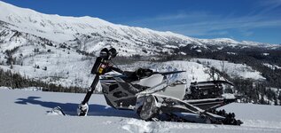

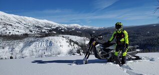

Pics below of average mountain ride. We ride in about 7 to 15 miles on the trail (15 miles to this area) and then ride off-trail all day, then back to the trailer. I'd expect about 10 miles of trail riding with the Varg, unfortunately (as we run 40+mph all the ride in).
