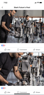

Yah, I noticed the radiator hoses from examining pictures really closely. And wonder why Mr Stark Varg didn’t mention in all of his MANNY in-depth interviews and videos almost like he was trying to hide something from all of us strange. And really when asked technical questions he really didn’t have a good answers almost like he’s the thought man behind the project and not the actual designer in engineer , but do wish him Success.Didn't even know there was a radiator...LOL. Crazy how this thing can be so much lighter than the Alta.
There is a fan. It is an actual radiator fan designed to be exposed to the elements -- not some computer fan. The electronics measures fan current draw and warns you if there is some problem with the fan. During charging the coolant pump and fan is controlled to bring the coolant temperature and motor copper temperature to ambient so that you start the "run" with a cool motor and cool coolant. If that sounds like an afterthought so be it.It almost seems like an afterthought...
Sounds like you may have had something to do with designing or implementing that component Any other insights you can impart to inquiring minds? Was it a balance or space issue to run the radiator in the back rather than the front? Does it cool only the motor, or also the controller? In an overheating incident, what happens? Does controller shut the motor down? Limit its power output??There is a fan. It is an actual radiator fan designed to be exposed to the elements -- not some computer fan. The electronics measures fan current draw and warns you if there is some problem with the fan. During charging the coolant pump and fan is controlled to bring the coolant temperature and motor copper temperature to ambient so that you start the "run" with a cool motor and cool coolant. If that sounds like an afterthought so be it.
