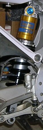

Results: It finally works the way it should, for me and my riding. When the throttle's twisted the rear instantly squats down, most or all weight shifts back, the tire digs in, and the bike takes off (all so different from the stock 'flat-spin' setup, for me at least). I feel the RW under me moving quickly tracking the ground, but few actual impacts make it through to the frame and traction's much improved - the rear tire seems to actually grab uneven/nasty stuff now rather than just spin over it. The RW hop problem it had during coasting/braking was worse at first, but I switched from my normal mode 4 to 3 and it just about vanished (I think the newly-reduced compression damping allowed the heavy map 4 regen to create more hop than before). I no longer find myself in 'avoidance mode' steering all over the place, but just riding through it. One "problem" is I'm going faster now that I trust the bike and map 3 rolls further than 4 when the throttle's chopped, so there've been some real dicey moments lately - gotta get a handle on it, which I'm happy to have to do. I've got my fork set up as close as possible to the shock (this is the 1st bike I've ever done that with, I'll post about the fork later), and I find the F/R differences pretty interesting. When my FW hits something like a 2x2, the unamplified wheel energy is applied equally to both sides of a frame-end pivot (steering stem) and the result is a pretty mellow-feeling 'bump' compared to the rear, which multiplies the energy 3x and delivers it to a single hard-point right under the seat (bam!).
The shock is an Ohlins KT 2194 shortened 22mm, custom 220 x 61mm 5.8 kg/mm spring (Cannon Racecraft), Redline Likewater 1.5W oil, 120 psi nitrogen/7mm res. piston clearance, sag 45S / 102R. This 'Flow' shock is well named; the conventional-type ported main piston adds a lot of oil-flow possibilities compared to a solid one, and the twin-tube design allows using much less compression than rebound damping (the OEM WP does not). The valving & piston below give near-maximum compression flow / minimal damping, plus normal-range rebound damping for the soft spring.
Shim info below; multiple thin shims are used to prevent deformation in both oil directions (nearly learned this the hard way in my AER fork). These stacks are intended for trail riding below 50 mph. If anyone's interested in trying these out and won't be doing the work themselves, I'd suggest using a non-Ohlins dealer (see below).

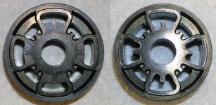

The shaft piston's mid-valve ports were opened up to Ohlins-max dimensions using a CNC wire machine (mod. on R, @ +20% MV flow):

OEM piston w/Ohlins RD & MV shim stacks, red 1.5mm? OEM spacer, black 2mm & 2 x blue 10mm shortening spacers:
