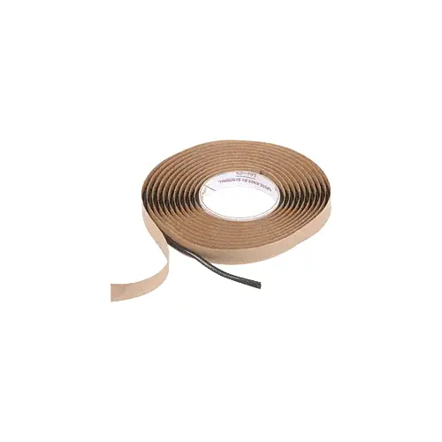

Sorry, I have no installation pics, but if you have the right tools, the job will be pretty simple.
All you need it a properly sized butyl tape. The R-pack battery uses a butyl sealant on the bottom cover. The A-pack, apparently, uses it on the top cover as well.
I lucked in and bought exactly what was needed the first time -- CRL Sunroof Butyl Sealant Tape.
It is about 9mm wide and 1.5mm thick, and long enough. One roll will probably let you seal a battery cover at least four times.
