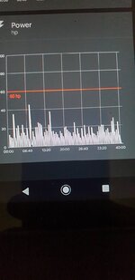

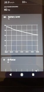

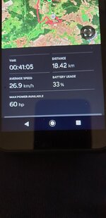

Good Morning!
I did it 1hour ago!
I went to an G4 area (you have to search for it in rural Germany).
AND when I stopped, switched in NEUTRAL the LED started to flash in several colours, like promised.
THEN press the UP button and then both (DOWN) LED became BLUE.
After 3 minutes it has been done.
I made 18km with the NEW software and I took 33% battery. (6°C) easy going.
I didn't notice the new features, sorry!
