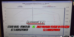

Here is a dyno chart from a very early Stark MX 80 hp comparing to a YZ450. You can forget about the lower YZ450 line, but the upper one is interesting. The 80hp being full power actually shows it's peak performance and thus efficiency.

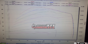

Below it we have the same dyno showing hp per 10hp setting.
It however isn't the full picture yet since actually the torque is the efficiency and with the curves in those lines it doesn't seem to be fully lineair.

If we take this to be true one would say the peak efficiency ends at 43 mph/69km/h.
If you with my riding involving 70 km/h as is now (and far more when it would be road legal in OTR events) you would think a higher gearing would actually shove this point to higher speeds and thus being more efficient.
