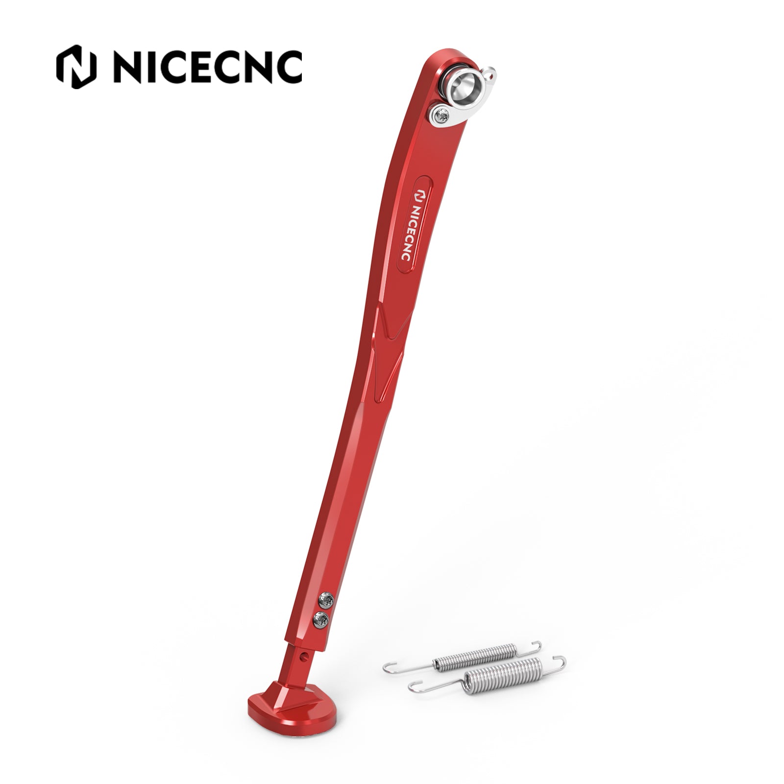

Back on topic:
New, adjustable kickstand from NiceCnc:
