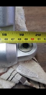

Yes, it looks like there definitely is a clearance problem, or at least the potential for one:
Fwiw, the shock on the right (2018 MXR) is 475mm eye-eye. Hopefully someone here who's actually changed out the 2017 shock will chime in. I wouldn't worry too much about shock overall length within 10mm or so, imo there's more than enough rear sag / fork height adjustment available to get it where you want it.

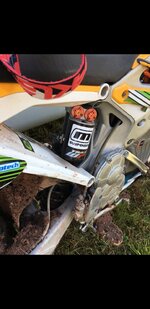

Have finally found a KYB KTM Technical Touch full factory set up from Belgium!, but the rear shock is 480mm eye to eye, that's still a 10mm short fall, again as above can anyone offer some help or advice on this shortfall, will it make the Alta to low on the rear end and handle like crap or just be to low?.
I am desperate for some new suspension and i have been looking for a the KYB for ages and now finally have the chance for a full kit.
The newer Cone valve rear shock that i pictured above is again 480mm long.
I have also sent a msg to Mark as i know he has a Traxx on the rear of his bike and hoping he will reply back.
Anyone have any advice, please....there are some on here with a lot of suspension knowledge!. (@TCMB371) I know @rayivers on here said above that he would not worry about 10mm or so, but i want to make sure as the Alta is already low pegs wise!. Is 10mm on the shock length just a 10mm exact drop in height on the Alta's rear?, is it as simple as that and would actually make it handle better like the KTM's do?.
This is the kit offered... I don't have much time to mess about and keep the seller waiting!.
Stock rear shock length is : 490mm.
rayivers
584
CT, USA
Imo 10mm shorter should work just fine, and you can always lower the forks slightly if needed - guess I'm repeating myself, sorry about that. :) I prefer more straight-line stability over quicker steering, so for me dropping the rear a bit works well.

pull your shock shaft down 10mm with a tie down and measure at the rear axle 90 degrees up to fender.......compare to the topped out measurement, that's how much travel you'll lose. It'll probably be 25mm or so shorter at the back I'm guessing.

OK, so going with a modded Traxx rear shock (Modded to 490mm) with a bladder kit and valving for me, question is :
