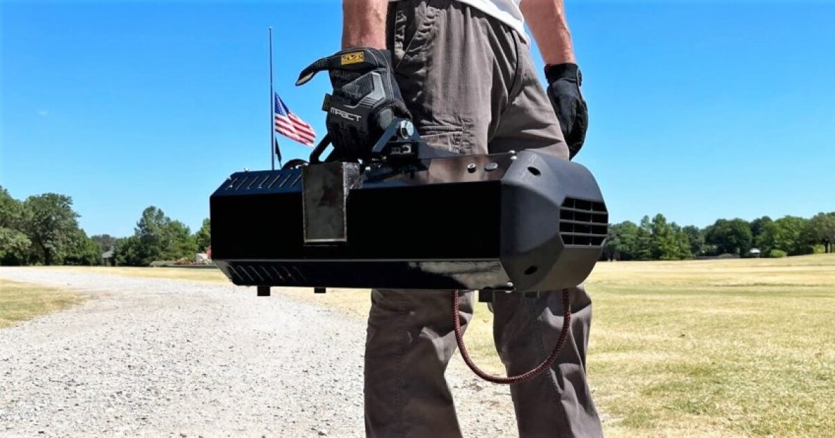

OMG! It is 116.5 decibels. My ears are already hurting just reading about it!
But at just 19.8 lb it would be nice if I could use it as a range extender on a commuter bike.
