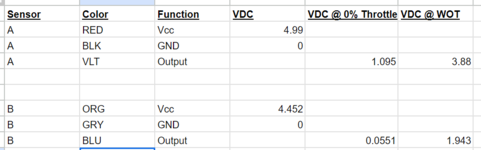

Excellent teardown. The 2-sensor design might be used for redundancy AFTER startup checklist but BEFORE startup, it is used as a parity check to confirm throttle position. Both sensors are required to work or the ACM will not pass the startup checklist. Here is a link to their datasheet: https://www.hirschmann-automotive.com/downloadFile/304 and here are the pinouts and voltages:
