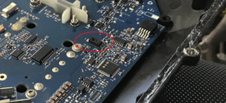

So to clear, what happened to my battery with the code 37, i removed the battery frame in 5 minutes. For that i layed the bike down to the side. Then i warmed up the battery around the seal of the bottom cover. 30-40 degree celsius where enough to soften the sealing. I removed the cover easlily with a screwdriver and then it fell off after warming up all the way around. Inside the bottom cover is a airbag which cares for pressure equalization, without getting humidity in! A very good idea, to do this that way! The airbag is connected to the outside air. So be careful not to hurt it. Under the airbag You will find the decassent bag. In my case it was already broken from shaking around during 6500 MX kms of hard MX! So i cleaned up everything, also removed the rest of the seal as clean as possible and fitted everthing together. Cleared the code with MT. Bike is running like new!
P.S: I was curious about my cells, so i opened the orange cover and checked the cells and wirebonds (Careful HIGH VOLTAGE!) But also there everything looked perfectly dry! So here we go for the next 6500kms!

Yes i cleaned it with a small screwdriver and a knife. i bought butylstring 4mm. Worked out pretty good. STRANGE: I have a EXR with 2000 km odo. Yesterday i got also code 37!!! Exact same situation: i went 5 stints with 12 minutes in the cartinghall at 10 degree C. Then i went home. Next day unloading the bike at 0 degrees! Code37!!!
UPDATE: Today i checked with Multitool both bikes: They had exactly the same humidity of 49%! I have no idea, why i got the same humidity warning on 2 bikes!?!

Code 37 is triggered when the humidity sensor reads >70% for over 60 continuous seconds. Check your log (will need to download it from the bike) and see if that had occurred.
