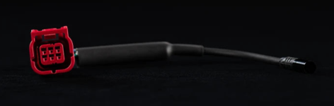

There's the OBD adapter that comes with EU Vargs VCU to OBD pigtail
Not cheap, but the red connector is fairly common. Or snap it off and solder the ends to the CAN interface
