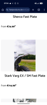

1000008647.pngFast Products makes a really slick plate support, you need to buy small indicators with it, I ordered the smallest one, will put it next weekend and post a picture of it
Well, after a dusty weekend of desert riding, looks like I need a new plate mount option. That Fast Products light looks like a good replacement, but they don't ship to the US :-(
