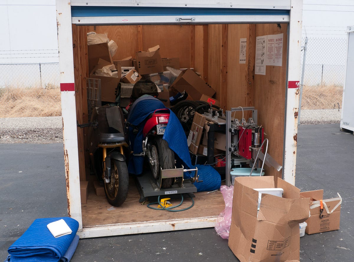

It still is! I really need to write another update, but I still own it and ride it occasionally:
That's a crazy story, kudos to you 👏
So you own the bike, you can ride it, and you own the rights?
I'm just a guy with an internet connection but I was so bummed when I saw Mission going down and couldn't believe that nothing would come out of this incredible motorcycle, that bike was so much ahead of its competition it was crazy. Plus it sure got the looks which is so needed when you're a startup in need of recognition.
Do you know if any of the team are still involved with electric vehicles?
