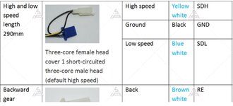

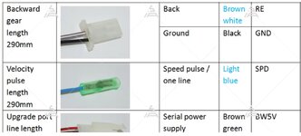

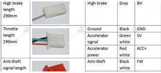

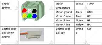

The wiring Harness I have is for the Votol, Only a few switches are different, I will see if i can find the Fardriver one. I have the controller side, I need the Wiring Harness side . Here are the main ones Key is B+ to this key wire, and it turns the controller on, throttle is throttle, 3 peed is 3 speed as set in the controller settings. Backwards is reverse.
This is a start, tell me what you have already as far as the wiring harness. And I read that your new controller is smooth. Your ND961000 is smaller than the ND961200, and they don't make a kit for yours as far I can see. but there is another way that I do it on the Votol. 3 main parts , the original RM radiator, right side with the cap. this Amazon pump, https://www.amazon.com/dp/B07JD8PXSR?tag=sce0f-20, and 2 of these cooling plates, https://www.amazon.com/dp/B07VMZGJPY?tag=sce0f-20 without the peltier coolers. ( the $45 choice)
