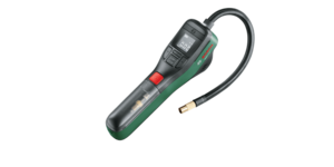

Probably just lost in translation, do you mean manual pump or electric pump? These work really well
