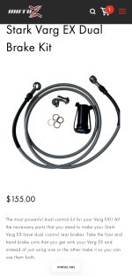

Anyone have any experience or preference with these companies Dual brake kits? Im wanting to install on my EX that has the foot brake installed but included a uninstalled brembo LHRB. I’ve seen each companies install video on YT but still Im undecided.
If all other things are equal, I would recommend the Racetorx, only because one of the banjo ends of the brake line has a bend, which I think would work better at the adapter on the foot master cylinder. But in the photo, it looks like they are using the bent end at the left hand MC, and it looks like the Formula left hand MC.

Motoz is a local dealer that i bought my bike from. It works great and would recommend it. You can call him on the phone and he super helpful if you have questions
