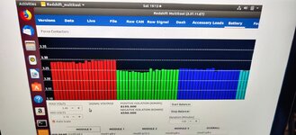

After riding my bike for a little while I checked the charge and the battery graph was displaying 0% SOC. No flashing of the display, no limiting of power. I was pretty confident I would be around 50% left when I stopped to check. I brought it home and connected multitool and noticed that module 0 was about 1 volt higher than the other three. I checked the battery graph and as you can see below the whole module is higher than the other three. This module was replaced earlier this year. I have checked the battery graph several times with multitool since we replaced module 0 and it has always been even with the other modules. While charging module 1-3 caught module 0 relatively quickly and then all 4 continued to rise evenly. Anyone have any thoughts? My thought is module 0 has much less time on it than the other 3 and losses charge more rapidly causing the imbalance. Another thought could be a BRD malfunction? I also had a code 37 pop up yesterday and the humidity sensor was reading 40%. Based on voltages of the modules I was at about 47% SOC when I plugged it into multitool. On the dash section it was reading 0% SOC.
