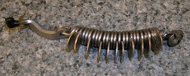

Glad I saved my change :) I did this with the springs stretched, it made everything so much easier:
