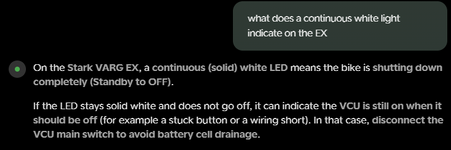

Also when i turn it off the indicator light often turns white. Anyone knows what that means?

Thanks for the asking Sam, the red button does indeed stick.
As for the whoite light.
Contacted Stark 10:05 this morning. They replied with a question, send them answer and a picture. Now at 13:32 i have confirmation they send me a new handlebar switch.
