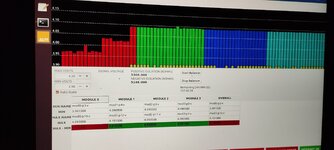

Thanks so much! How low was your p-group compared to the other cells? This is what mine looks like..

That appears to be much worse than mine. Glad to see you have had good success!

In my case, the bike didn't charge more than 50% and that was the only reason to fix the code, if it doesn't affect your power reserve and charge, I wouldn't even solve it. There is also a problem of disconnecting connections between cells, then it needs to be fixed and it also causes code 35, 36.
