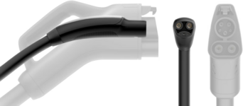

Alright, so I'm following up on my j1772 thread. I now understand that the Varg has no ability to convert AC to DC onboard. So, that brings me to a new question... DC Fast Charging. Is it possible to create a connector that can negotiate with either CCS or NACS to provide the proper charge to the Varg?
Those connectors are huge, especially CCS. They take up a lot of space and weight even on a "large" street bike. Nobody was thinking about motorcycles when deciding for DC charging standards. That said, just like Philip said, it wouldn't be difficult to make an adapter cable with comms translation from CAN to the appropriate standard.
Another interesting product would be a charger to charge the bike straight from the DC charge port of and EV car/truck:
Some people are using the 230VAC port on Cyber Trucks to charge Vargs. Here we have the following path DC (car’s battery)→ Inverter→ 230VAC → Charger → DC (bike’s battery). Here you would do well to have 70% efficiency. We could go like this: DC (car’s battery)→ DC-DC-buck-boost→ DC (bike’s battery) which will give efficiency of 95% or better.
I just don't know if there is enough of a potential market for this. My guess is no but I could be wrong. I didn't think of the CCS to Varg before; it is an interesting idea. Still, not sure how many units could be sold... and what Stark would think of someone external to the company doing that.

Is nacs viable from a size perspective on a bike? One day I'd love to see v2v available. Go for a rip in the morning, come back to the staging area for lunch and top up the enduro bike from your vehicle, then headout for the afternoon on a full charge with no range anxiety.
