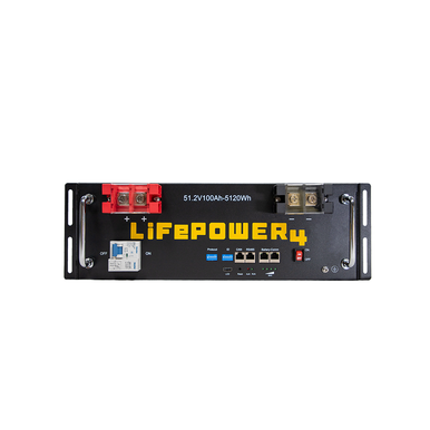

I would start with a gas generator. You need at least 3.3kw continuous power at 220v to fast charge. This is the best buy, IMHO, that meets the Starks fast charge needs:
If you want to go solar, I have a 20' cargo trailer. I've purchased all the solar stuff but haven't installed in yet (injured ankles in a moto crash). You can build a massive solar system for under 5k. I'm also going to use the solar on the trailer to charge our Teslas when we the trailer is parked at home.
Panels:
400W+ residential panels work well.
signaturesolar.com/aionrise-395w-mono-crystalline-perc-solar-panel-black-aion72g1
All in One Inverter:
This will accept input from solar, generator, battery bank and shore power. Makes wiring much, much easier.
Battery Bank:
Big boy (2x Stark battery):
Small size (need two of them to fully charge Stark)
The All in One Inverter and compatible batteries make this system very easy to wire up. Tons of videos on YT explaining how to do it.
Panels:
signaturesolar.com/eg4-6000xp-off-grid-inverter-split-phase
Battery Bank:
signaturesolar.com
signaturesolar.com/eg4-lifepower4-v2-lithium-battery-48v-100ah-server-rack-battery-ul1973-ul9540a-10-year-warranty
Panels:
Battery Bank:
signaturesolar.com/eg4-wallmount-indoor-battery-48v-280ah-14-3kwh-indoor-heated-ul1973-ul9540a-10-year-warranty
