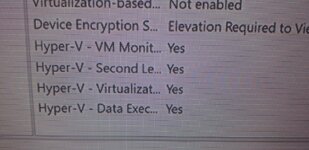

Also, make sure your Laptop you want to install this on has Hyper-V
To check if you do and its available and working just type "MSINFO32" into the search bar bottom left (on a windows machine).
Its not that hard to make it all work, just give your self plenty of time to download and run it all, don't do it in a rush!.
