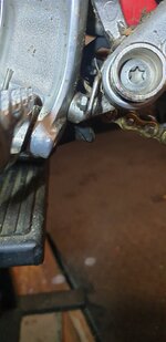

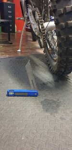

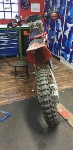

The kickstand issue was annoying me so I made a temporary extension for now till Stark comes out with a proper length kickstand. I looked for an aftermarket option but I couldn’t find one long enough. I added 2”… it’s a little long on hard surfaces but will work good on dirt. It looks hackish but it works for now.
On a side note, I can’t believe Stark, as good as their engineering is, completely missed the mark on the kickstand by 1.75” - 2”. Kinda shocking 😳.IMG_1244.jpegIMG_1245.jpeg

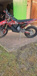

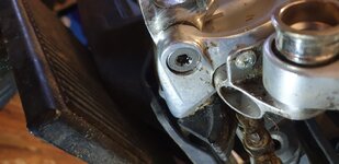

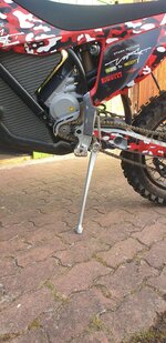

My side stand solution following the idea from our Swedish friend in his video.
Not easy to drill the 5mm hole, but only 1 drill broken;-))

Can you tell me the thickness of the head of the bolt you used to shim the kickstand?
Also any pictures directly from the side with the bike on the kickstand?
