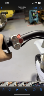

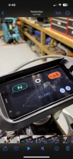

i need help i pressure washed it and now when i turn on the stark the led will do the normal blink green but then shortly after it will go static red and the bike doesn’t go into gear
Aleksandar13
134
Uk
Did you try to press both up and down button at the same time for 5 sec or more until it blinks white?! That reboots the bike I think that's what my dealer told me. Give it a go
Did you charge your battery and try it again? Also, did you try to dry out the power button assembly? It connects under the front number plate you could try to make sure those contacts are dry?
fsfs
HRV
Chances that it is the battery is low (not low battery but low probability the the battery is at fault). The weak points are the small white JST connectors behind the number plate and the switch assembly itself. Un-connect the connectors and take the switch assembly apart. Dry with hair dryer. Leave it at ambient temperature for a several hours (like over night), and then re-assemble everything.
