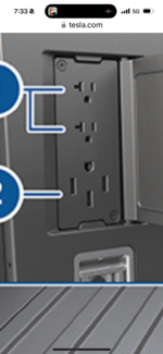

Tesla cybertruck 240v plug adapter type?
PsychoBunny
11
Southern California
Was googling and it seems like I need a Nema 14-50r to Nema L14-30 plug.
I pinged stark to see if they have some or any recommendations. I remember reading some folks had issues with none stark cable adapters.
4,448
I think you are right, except the P and R (plug and receptacle) should should be reversed.
Nema 14-50P is the household laundry dryer plug that would plug into the Cybertruck.
Nema L14-30R is a locking receptacle for the "generator plug".
