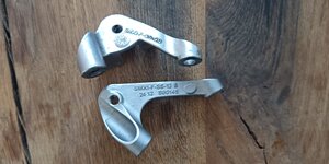

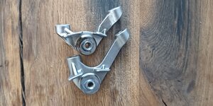

- Side stand bracket:
The sidestand bracket from the EX SMX1-F-SS-13 is longer and thus finally the bike stands up straight. The older MX version works perfect for SM conversions though.
