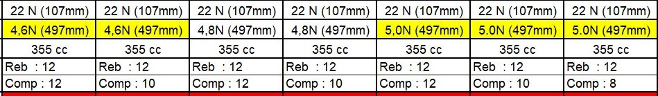

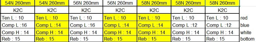

Asked also the clicker settings from the support, and they sent the tables for each weight category. Tables attached. Settings from 65kg/70kg on to 95kg/100kg respectively from right to left. Five star customer service from stark future :giggle:

Shock:
65/70kg 70/75kg 75/80kg 80/85kg 85/90kg 90/95kg 95/100kg
Fork:
KHL 15-11oil // KYB spec
Total oil of one fork leg is 550cL
