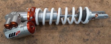

Well, here is my interpretation of WP suspension on the Stark. I didn't want to go as far a cutting into the frame, but one of the advantages of the WP stuff is that it is modular and there are quite a few different parts available. There are a few options in the Xact Pro shock series, but the shock used above, 19-22 Xact Pro 8950 part#18180T07SET, checks most of the boxes. In general with the Supertrax system on the pro shock it is way easier to swap out the top shock body than to fiddle with the clevis where the rebound and fast rebound (Supertrax) is located. It also helped that the previous gen shocks (19-22) can be found for little money and I got a new shock for almost 60% off of MSRP. So I started with that:
turned it into this:
mixed it with some parts I already had:
and was pretty happy how it turned out:
It is a close fit with the preload adjuster and to reach the rebound clicker, but basically it fits like it was made for the Stark - no rubbing or touching, all the clickers can be reached fine.
