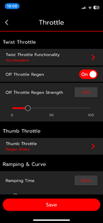

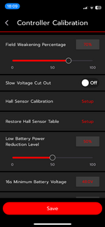

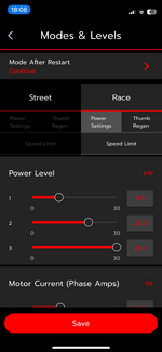

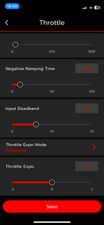

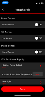

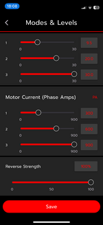

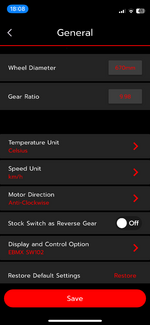

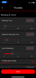

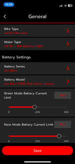

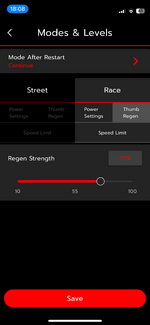

I know that in the "heat of the battle," it is hard to keep from using all the power available. @fmxxx666 sent me his X-9000 settings and they work really well. In the upper two power levels, I can barely hold on to the handlebars. The front wheel just doesn't want to stay down.
When I compare the performance/torque of my QS138 V3 against my YZ450 gas bike, the YZ is super slow. My QS138 V3 is putting out 125 lb./ft of torque while my YZ puts out about 33 lb./ft of torque. Power wise, I couldn't be happier. I've found that 350a of current with 900 phase amps at 70% field weakening works great. So far, I've had no heat issues. I'll start posting results as I do more testing. However, I try to keep an eye on my voltage level, amperage draw, and battery/motor/controller temperatures.
Below are the X-9000 settings I'm using from @fmxxx666:
