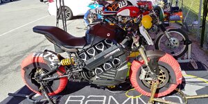

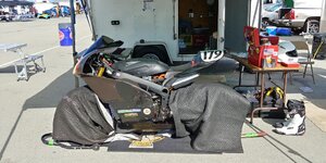

I remember I went to an AHRMA race and they have a class called Formula Lightning and it's an all electric class and I talked to this guy that had oil cooled his Zero SR motor. I wish I got a better picture of it. He must have machined some kind of jacket to fit over the motor and pumped oil around the motor. He said it helped the bike run longer without overheating. Energica does the same thing to their motor they oil cooled it. Their newer bikes have watercooling.
In the picture you can see some little red hoses those are cooling the motor.
I used to have an Empulse TT and that was watercooled also.

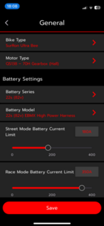

I know that in the "heat of the battle," it is hard to keep from using all the power available. @fmxxx666 sent me his X-9000 settings and they work really well. In the upper two power levels, I can barely hold on to the handlebars. The front wheel just doesn't want to stay down.
When I compare the performance/torque of my QS138 V3 against my YZ450 gas bike, the YZ is super slow. My QS138 V3 is putting out 125 lb./ft of torque while my YZ puts out about 33 lb./ft of torque. Power wise, I couldn't be happier. I've found that 350a of current with 900 phase amps at 70% field weakening works great. So far, I've had no heat issues. I'll start posting results as I do more testing. However, I try to keep an eye on my voltage level, amperage draw, and battery/motor/controller temperatures.
Below are the X-9000 settings I'm using from @fmxxx666:
