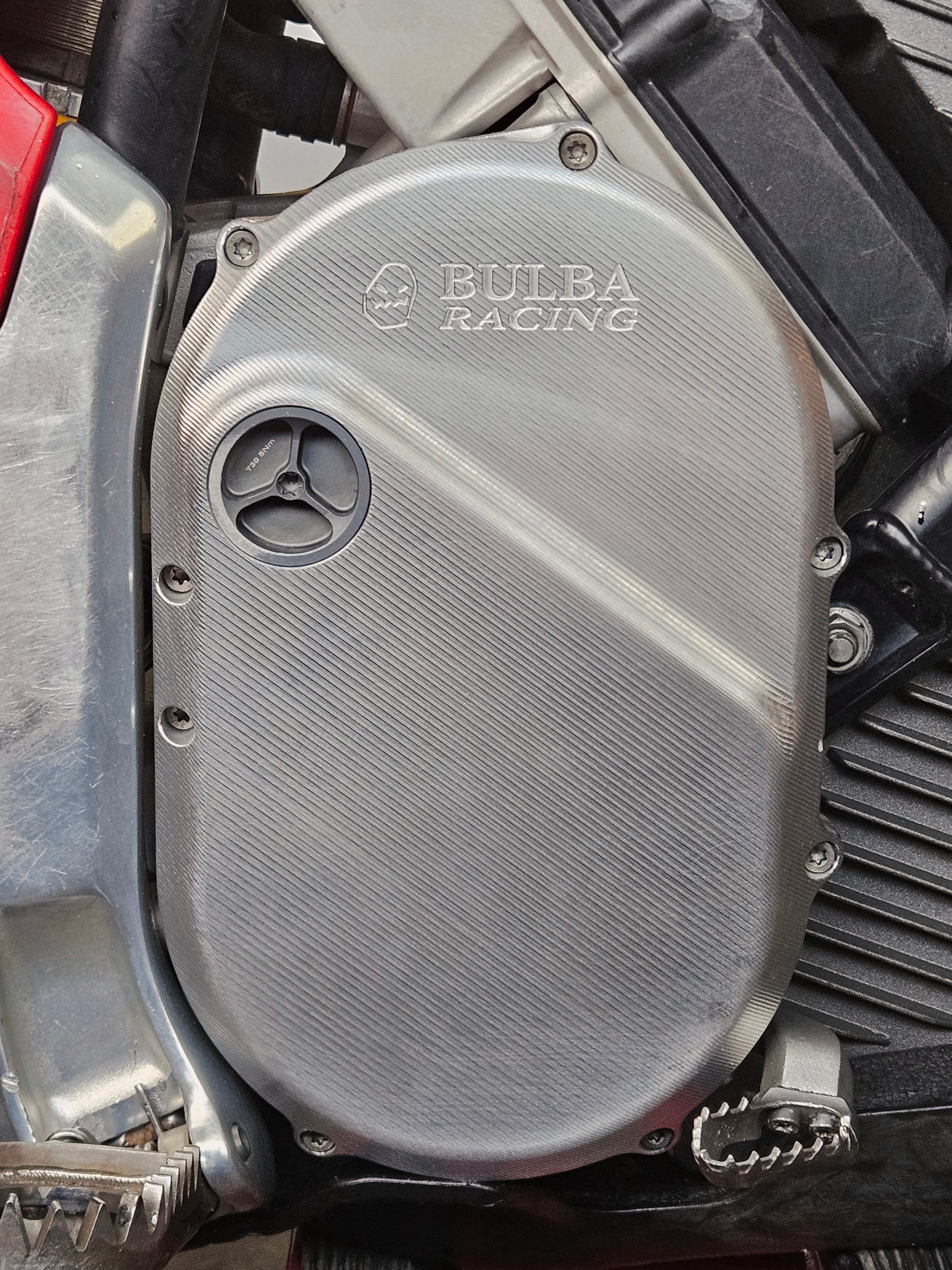

Also all that beautifull cnc machined aluminium will get scratched so quickly it's not even funny 😁.
It also looks black oxided and I'm afraid that such a surface treatment would be worn quickly even without accidents, because of the boot rubbing against the cover, especially if there is a foot operated rear brake.

On only my 2nd ride I damaged the side casing in a little 5mph tumble.
Ordered a replacement from Racetorx late on Sunday, it arrived today (Tuesday) and that's between Christmas and New year. Amazing service, thanks Racetorx IMG_20241231_135019.jpg

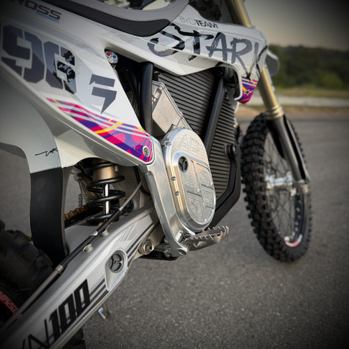

I think one of the best things you can come up with is damping like the bashplate of the Stark. The easy DIY would mean some thick rubber over the casing. Like from a ultra heavy duty tyre.

Still waiting for someone to make a more complete protection.
