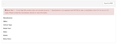

Uhh CoC is going to be needed to register for CA. No CoC. No title - no green sticker
NHTSA - is reporting this when your VIN is looked up:
notna

Called The Motor Cafe, they promised to investigate and call me back.
@Rashid510 is also going to reach out through his channels and see if he can figure something out.
Stark Future support has no responded to my question regarding VIN and CO.

Got this response from Stark Future support:
Sorry for any inconvenience this has created for you. There was a slight delay with printing MCO's but yours will be in the mail tomorrow. The NHTSA VIN lookup is searching the on road VIN database and the VARG is obviously an off road only motorcycle, so this may be the issue. We are working to get this sorted out now. Thank your for you patience.
@dpwracing ^
