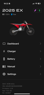

I briefly shared some details on this in a thread about extracting soc data but I've built an alternative app to the stock Stark one. This app runs on both iOS and Android while supporting most of the stock app features except "writing" configuration data like maps, charge rate, and other bike settings (these may come in the future). In addition to the stock information the app also provides access to all of the diagnostics data the VCU provides. This data is normally recorded during rides and uploaded to Stark via the phone, however it's obviously very useful to have this information available for end-users and dealers. Long term I have no clue whether Stark will try and prevent third-party apps from accessing VCU data, however as the app never writes data to the VCU it shouldn't void your warranty in places with strong consumer protection laws (at least in the US I know your fine). I am hopeful they see the value in third-party support and have an overall mentality of right-to-repair, but they could choose to brick this app in the future if not.

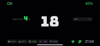

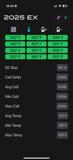

Here is an example of some of the functionality, there is a lot more data provided within this app but it all requires a bit of thinking and knowledge to use, so I'll leave that for people to explore on their own.
(kw value is totally wrong in this screenshot)
And finally this is a 35 minute cut of a (street-only) ride I did with the app displayed as an overlay the entire time. This is an older version so not everything is perfect but should still give you an idea of how it works in comparison to the stock version.

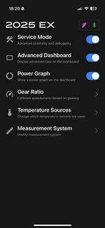

I'm really interested in the speedometer based on the gear ratio. As I've changed the gearing of my bike for both my dirt wheels and SM wheels, it would be nice to know what my speed is instead of guessing based on a percentage change I've roughly calculated.
Is this a feature that's build into the VCU stock or a layer you've added for the speed display?

Sadly not built into the VCU which just gives the calibrated speed (in kmh and using their static drive-ratio) and the motor RPM.
